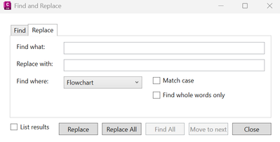

You can save some time when creating those shapes in Subassembly Composer using copy/paste into the flowchart and then modify a few point/link geometry properties to get almost everything set up.
I was talking about switches in the previous post, but there is another way that can get you out of that. I'll try to break down the process...

On the other hand, a completely different thing is if you wanted to find/replace something. Then, you must go to the Edit menu, then to find and replace, and explore the possibilities the software offers to see if what you want is actually possible.
I hope any of the previous helps. Best regards!

Hi @Vinicius_Estrelow, editing the programming of a PKT sounds very interesting, but I don't have information on how to do it, and have never seen in this forum any related information. I'm sorry not being able to help with that.
I hope you find any of my posts so far helpful. Best regards and good luck creating your custom subassembly.
