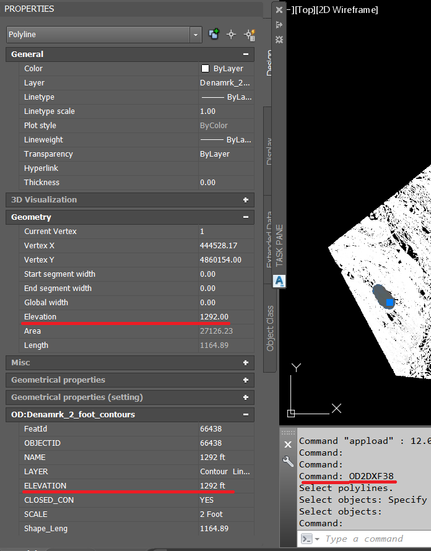

I have a lisp that I've written that converts flat polylines, imported in by mapImport, and applies the elevation to the polyline. I've tested it with your contours and it works fine. It looks at the elevation field of your choosing and is able to drop and ignore the "ft" in the field value. Let me know if that would help.

Similar to the proposed hippe01 - with the help of a ready-made OD2DXF38.lsp from CADaSchtroumpf, you can immediately after MAPIMPORT, without changing the field type, leaving "ft," in about 3 minutes give all polylines a Elevation based on the value from the ELEVATION field.
But before that, you need to replace the Lines primitives with Polylines with OD preservation. (For example, MAPCLEAN).
How to use lisp:
1. Download lisp file - APPLOAD.
2. Enter command at the command prompt. (For example, OD2DXF38).
3. Perform the actions required by this lisp.

АлексЮстасу
If there is a purpose not to use lisp, then it is understandable.
But here lisp (from hippe01, from CADaSchtroumpf) gives a significant saving of time and action, and the possibility of errors in imperfect actions is excluded.
1. No "ft" delete actions are required. You do not need to work in QGIS or change the field type in OD. The original data is saved completely.
2. You do not need to make a query to assign Elevation, get a new file, attach, detach, close, open files, etc.
3. Everything is done in the active file immediately after MAPIMPORT in one action.
-- Alexander, private person, pacifist, english only with translator 🙂 --

АлексЮстасу
@Pointdump wrote:
"...you need to replace the Lines primitives with Polylines with OD preservation."
More detail on that please. How would you go about doing that? And aren't contours already polylines?
You can convert Lines to Polylines by MAPCLEAN saving the OD. In the Cleanup Methods tab, select Line to Polyline.
Yes, there are Lines after import. You can get rid of most by selecting the Dissolve Pseudo Nodes action - merge with polylines.
But your skepticism is partly justified. For example, OD2DXF38.lsp from CADaSchtroumpf will not give a Line height. And Map will raise Line.
