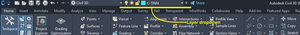

To add the Layer Dropdown do this:
1. In the Ribbon, Home Tab=>Layers Panel=>Right-click the 'empty space' next to your Current Layer=>Select Add to Quick Access Toolbar
Image-1Image-1
2. The Layer Dropdown will appear in the QAT.Image-2Image-2
