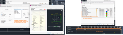

Hi again, guys. If all the layers are turned on and not frozen, then you must check the Layout tab of every band detail in the section Labels and Ticks. (see the image)

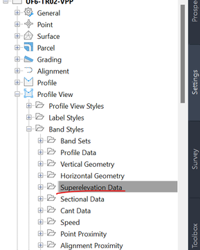

Go to your superelevation band style commonly located here
Open your style and then go to "Band details," then go to every single component of the section "Labels and ticks" and open it by clicking "compose label." When there, make sure that in the "Layout tab," each of those components shows the information you need. If the text component editor is empty, any label won't appear in the model.
If this is the case, then add the information to the text component editor (in the image I posted, you can see the station value is assigned to the component Normal Crown, and therefore, it is visible in the model), hit OK, and then go back to keep checking the label components.
