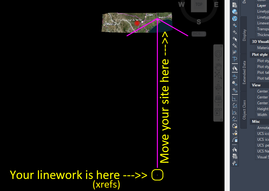

6. OPTIONAL. If you wish to make your new drawing with the inserted xrefs geospatially accurate so their X/Y coordinates AND their Lat/Longs are both consistent with real world equator and real world north pole, continue reading.
Someone, maybe your boss or maybe you, moved the floor plan and the survey linework southward by 10,000,000 feet. Or maybe the surveyor created an ADJUSTED  State Plane coordinate system so he'd have smaller Y-values. Then the floor plan designer might have simply followed the surveyor. No a big deal, right? Any-whoo, the Y-values in the xrefs are currently undervalued by exactly 10,000,000 feet.
Does anyone care about the sound of one hand clapping? If a tree falls in a forest does the Pope hear it? If a user moves an xref 10,000,000 feet to the south, does it really affect your drawing? It doesn't affect your drawing unless you want it to be geospatially accurate so the Lat/Longs are correct and you want to use Bing Aerial imagery as a basemap (see image-6).
Image-6Image-6
7. Select both xrefs and move them north 10,000,000 feet. Turn on ortho when moving them. You don't need to move in the X-direction, no moving to the left and no moving right, just move directly towards the top of your monitor. Be accurate. Move straight and you'll end up with a drawing that's consistent when Bing imagery is turned on (see image-7).
