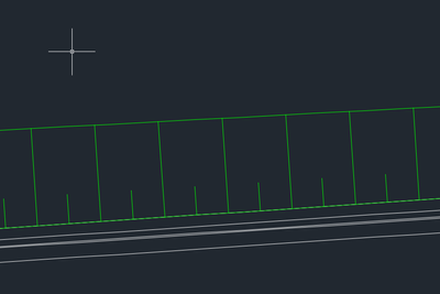

Hi to everyone. I am wondering if there is a simple way to achieve a style for presenting the daylight at an embankment as in the picture below
I have considered to create a custom linetype, which i could apply from the code set style. The problem with that is that the embankment height is varying, so this can not serve my scope. Is there any other way? Maybe through hatch or something else?

Hey @jimgi78okt!
Have you tried the slope pattern from the corridor properties? You can add these patterns and apply different styles, check it out: https://www.youtube.com/watch?v=LzN0lPoawcA.

Matheus i have not checked it. Still learning! As i saw the video this must be the answer! Thanks a lot!
