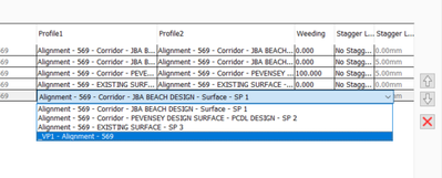

I want to create bands for my profile view but want to give values to specific chainages or corresponding chainages only. (see the below screensnap for reference). Please suggest some way to do this.

How about trying a ghost profile just for those labels. Add a VP in, puting verticies where you need them, and get your bands to pick up information from that profile, just turn it off or non plotable for presentation. Then overlapping the position of the band with your regular chainage band if need be.

@ianjchap . I have a doubt in this. Even after i create a dummy profile and put the vertices where i need them, how do i get values specific to those vertices in bands? My band takes values at specific intervals and not at specific vertices.
Please elaborate on this.

Step 1 - Create a new band copying the Station Band Style - give it a different name (Ghost Chainage - see step 1 image).
Step 2 - Remove Major and Minor Ticks from new band and values (see step 2 images)
Step 3 - Add Geometry points to Ghost Profile where needed - (see step 3 images)
Step 4 - Add gemetry points to the Band and include the new Ghost Profile (see step 4 images
Finally, you should have a bamd with chainage station at given/decided points. Tou could also set elevations to this for other profiles. And for completness you could overlap your station bands.
Hope this helps, there are some minor steps between these instructions that I assume you could be ok with, if not, let me know. And if I've misunderstood any part of what you're after.

Please check this file. I have created ghost profile names "LR", "RR" etc. I am able to add station band to one of the ghost profile but not able to add the elevation values.
Please help with regard to this.

You are only two clicks away! 🙂
In your Level Band, you just need to open the Geomery Points:-
And then select Points of Vertical Intersection:-

I've also realised you could do this by adding Geometry points to your alignment, then you should be able to link the levels to whichever profile you choose. Could be an easier option.

I think if you add verticies on your Alignment where you want band labels to be picked up on your Profile View, you could do it that way also. Then referencing a Profile for the Elevations. That should work too, and may be easier than the Ghost Profile.
I somehow think you can do this using custom labels directly on the Profile View. Something to explore.
