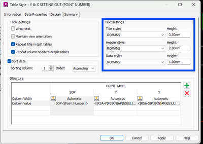

As far as i am aware the row & column sizes are directly related to the Text height's.  as per my image bellow. i had a look and there is no manual way to edit the row or column sizes. With Regards to the Legends there is no auto method to creating them unfortunately.

Actually, you can manually define the width of the columns by clicking the "Automatic" square in the column width row.  That can be useful if you want uniform widths across the columns.  The row height, however, is tied to the text height.

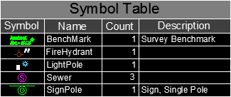

If you were to consider third party add-ons, read on.  DotSoft's C3DTools will generate (and update on-demand) linetype and symbol tables as CAD tables, and a lot more.  The tables intentionally do not reflect all defined objects, only those actually used in model space.
