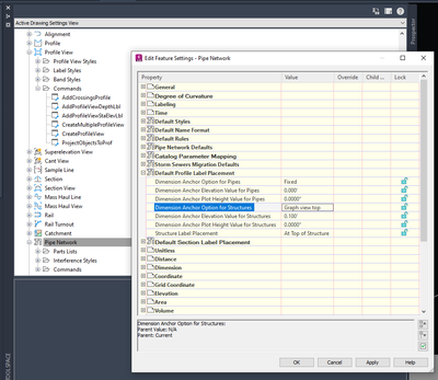

I don't think this is possible, but I shall ask anyways. I know I can set anchor options for anything profile label related but is it at all possible to get this to work for structure labels or is it an entirely different animal? I have to manually drag all my gravity structure labels to the top outside of my profile view grid.

Here you can set a default anchor location for structure labels in a profile view to be anchored to the top of the view.

Wunderbar!! I thought since my label style has a vertical drag state this may not work but low and behold it did. Thanks Mucho!!
