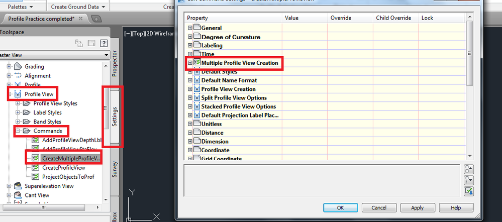

Good morning with all, I hope you are well, today I come with a concern that I have with the command to create multiple views of the profile, I attach a video, and the draw where you can better appreciate the problem, I explain that is what torments me.
When creating these profile views, I set up the styles of profiles and how they should be seen, including the shaded area of the cut and fill, but when they are drawn they show another style and do not leave the shading, I thought maybe it was the configuration of the command but as you will see in the video this is not the problem since all the commands related to the object were configured before drawing the multiple views.
Sincerely hope some of you can help a learner of this great software, I would appreciate it infinitely.

Jeew-m
Dear Friend,
I think you should edit the command settings to achieve this..

Hello @bepastor
I'm just checking in to see if you need more help with this. Did the reply of @Jeew-m work for you?
If so, please hit the ‘Accept as Solution’ button if/when relevant so, that others can more easily benefit from the information and thank you for doing so.

bepastor
thanks for your prompt reply Jeew-mm
Very good point, but as it says, already configured the commands, also in the video comes out all the configuration of this same.

Hi @bepastor
You must edit Profile View=>commands=>CreateMultipleProfileView as desired as @Jeew-m suggested to get profile view you desire. After you have made those changes recreate your profile views in your drawing. Hope this helps!
Please select the ‘Accept as Solution’ button if my post solves your issue or answers your question so, other Community members may benefit and thank you for doing so, and I'm here to help.

I am having a problem with the multiple view also. I want the views split but they are no longer splitting. I found the command in mentioned but do not know what to change to make the split active? Please help.
