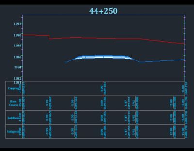

please can you help me? what is the reason behind my Road Cross section?

Not seeing the correct profile and targets?

Hi Kidus,
Welcome to the Civil 3D forum. Thanks for reaching out to the forum. As Joe pointed out, it seems that your section view is not displaying the cut and fill daylight lines, and the section itself is truncated.
I will examine the surface from which the cut and fill daylight is being generated and also verify whether a surface boundary is defined. It's important to note that if the section view extends beyond the surface limits, the cut-and-fill daylight might not be visible.
If you can, please share your DWG file with us. I am confident that some of our members will be able to provide you with a prompt solution.

please can you help me? what is the reason behind my Road Cross section? I attach my Civil 3d File Please Comment thank you
Joe-Bouza
make sure your corridor is rebuilt. It was not when I opened it
I suspect the limit of EG-ak is not wide enough for the sub assembly to reach. also, there are several corridors in here. Who is who in the zoo?
