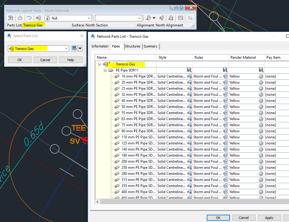

Hoping this is an easy question.
I had a whole network of pipes in a drawing working
If I change the parts list to any of the others I can access all the pipes, it's just the one I need, and have already used that doesn't work. The structures seem to show up just fine.
If I go into the parts list it shows numerous pipes available so I'm not sure what the problem is.
Any suggestions would be greatly appreciated.
- I'm using AutoCAD Civil 3D 2018.
Thanks.

Hi there-
I have got that before in previous versions at times.  My only workaround is to close Civil 3D and open dwg again...it should populate your list in the Layout Toolbar once you reopen.  I'm not sure why it does that.
I hope this helps.

I've already tried that but no such luck!

Sorry to hear that!
Please try the fix presented in this thread from AKN:
https://knowledge.autodesk.com/support/autocad-civil-3d/troubleshooting/caas/sfdcarticles/sfdcarticl...

Hello @victoriamilne1
Sorry to hear that you are having this issue but, take a look at this solved <<post>> to see if this address the problem you are having. This post suggests reviewing your pipe network catalog location settings "Setnetworkcatalog" are correct. I hope this helps solve your issue.

This worked Wendell, thanks.
