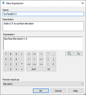

If the two elevations are a consistent elevation difference between the two you could do it with an expression that adds, or subtracts, a certain amount from the single surface location to derive the second.  Use it in a surface label along with a regular surface elevation.

That's a great idea. They are not a consistent elevation difference from one another in this case though.
