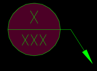

I had another one of these pop up this week. Interestingly, it's always been the same type of drawing that we do over and over. It's strictly 2D with nothing but standard details in it.
This time I tried switching from modelspace to paperspace (no viewports in paperspace), and I was able to save after that. Close the drawing and the issue comes right back.
After some extensive testing, I found the culprit that was causing the issue (at least in this case)
I had a multileader style that referenced a block. (see pic below)
The block had two attributes that were set to be multiline attributes. I revised the block to have single line attributes, and the issue went away.
Hope this helps someone.
