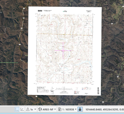

I am having difficulty inserting a USGS topo map into my drawing.  My drawing is set on State Plane coordinates.  The USGS topo map is NAD83 with TM projection. https://ngmdb.usgs.gov/topoview/viewer/#13/35.6875/-92.3125 is the link. The header image file is:
2.032
0
0
-2.032
492604.97238
3957790.68834
When I use Raster to transform it gives message "The coordinate system chosen for this image is invalid".  Any ideas how to fix this or what coordinate system I should be using?  Thanks.

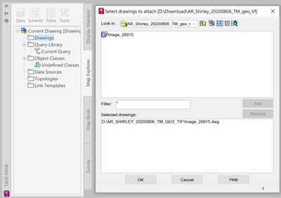

Use Raster Tools IINSERT to bring the image into a drawing assigned EPSG:26915 NAD83/UTM zone15N. Save and Close the drawing.
Open a new drawing assigned EPSG:3433 NAD83/Arkansas North(ftUS). In the Map Explorer Tab of Map Task Pane (MAPWSPACE >> Show), Attach the UTM drawing. Query >> Location >> All >> Execute Query.

Thank you for reply but it looks like the inserted "Shirley" USGS 24K map is inserted in the wrong location relative to the Geolocation online map.  It looks about 40 or 50 miles off.  I have spend a couple hours on this and am stumped. Any other ideas?

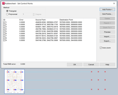

One other way to beat these images into submission would be to use Raster Tools Rubbersheet to make them conform to UTM83-15.

Well I still can't get it to work. I insert the topo map and they are still on top of each other.  If the X value in  the header file is only 20 meters or so different then won't the image only be offset 20 meters?  Should be about 11,300 meters, give or take, to move one far enough so they don't overlap.
And also, when I turn on ESRI maps it shows to be in Algeria.  I'm out of ideas.

Proof of the pudding is C3D coords matching the map grids. They do for me. Don't go by the TFW file. And if nothing else works for you, use the rubbersheet command in the Raster Tools to geo-reference the maps.
