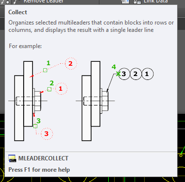

MMcCall402
Have a look at using multiple single circle multileader objects and then using the MLeadercollect function to collect them into one object with one leader.
