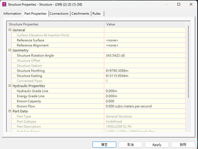

I want to edit the insertion rim elevation of the manhole but I don't know why I can't edit it. In structure property I also can't find the insertion rim elevation. Please help me ASAP.
524 Views
Joe-Bouza
If you don’t have surface to get surface elevation you can edit structure rr properties scroll down to “automatic surface adjustment “ and key in your rim
Joe Bouza
cwr-pae
Can you post a screen shot / snip of what you see in the Structure Properties dialog?

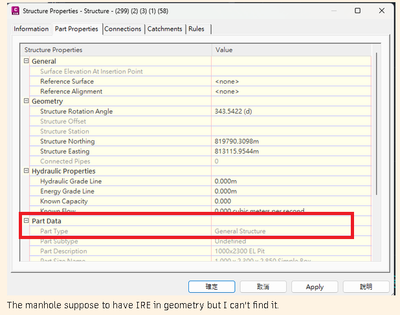

The manhole suppose to have IRE in geometry but I can't find it.
Joe-Bouza
Is this structure one from the OutOfTheBox (OOTB) or a custom part? What is a general structure? Change to Junction
Joe Bouza
paulaD5V2S
I think this manhole is custom one as it is my previous colleague made it. I give up this manhole and try to use other manhole that have IRE, width and length. thank you yr help
MMcCall402
Appears to be a custom structure that wasn't built to have a rim insertion point, like a Null structure.
