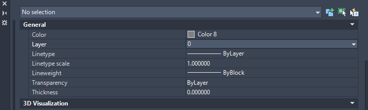

I have noticed an inconsistency related to the display of Layer 0 and its associated color.
When I click anywhere on the screen that is not part of the drawing, Layer 0 is correctly displayed as white, which is the default color. However, when I click anywhere on the screen and use the Properties command, the General section shows the color 8 instead of white.
I would appreciate your help in understanding why this is happening and how I can resolve it.
Could you kindly provide insights into the following:
Why does Layer 0 display as white when clicking outside the drawing but show as color 8 in the Properties command? and how can I fix this?
Thank you!

Would it be possible to upload two screenshots?
  1. screenshot of properties palette including general section showing color=>white
  2. screenshot of properties palette including general section showing color=>8
Make sure both screenshots ‘capture’ the top portion of the properties palette.
Chicagolooper
michelle_ghosbditghosn
Hi @ChicagoLooper
Kindly find screenshots

ChicagoLooper
@michelle_ghosbditghosn
Regarding your uploaded screenshots in Post #3, which one is from modelspace? Which one from a Layout Tab?
Or are both from modelspace? Or both from Layout Tab?
If you are NOT selecting anything in both screenshots AND both images reflect conditions in modelspace,  then the colors in the Properties Palette should be the same. Since one is white and the other is 8, this indicates you’re doing something different from your original description.
By default, both your screenshots should display:
  1. No Selection
  2. Layer=0
  3. Color=ByLayer
Without anything selected, the color in the Properties Palette, whether (a) white, (b) 8, or (c) any other possible color, indicates the default color is being overwritten. The out-of-the-box default color = ByLayer.

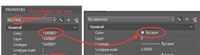

ChicagoLooper
  1. CNTL+A
  2. Go to Properties Palette=>Color=>ByLayer
Chicagolooper
