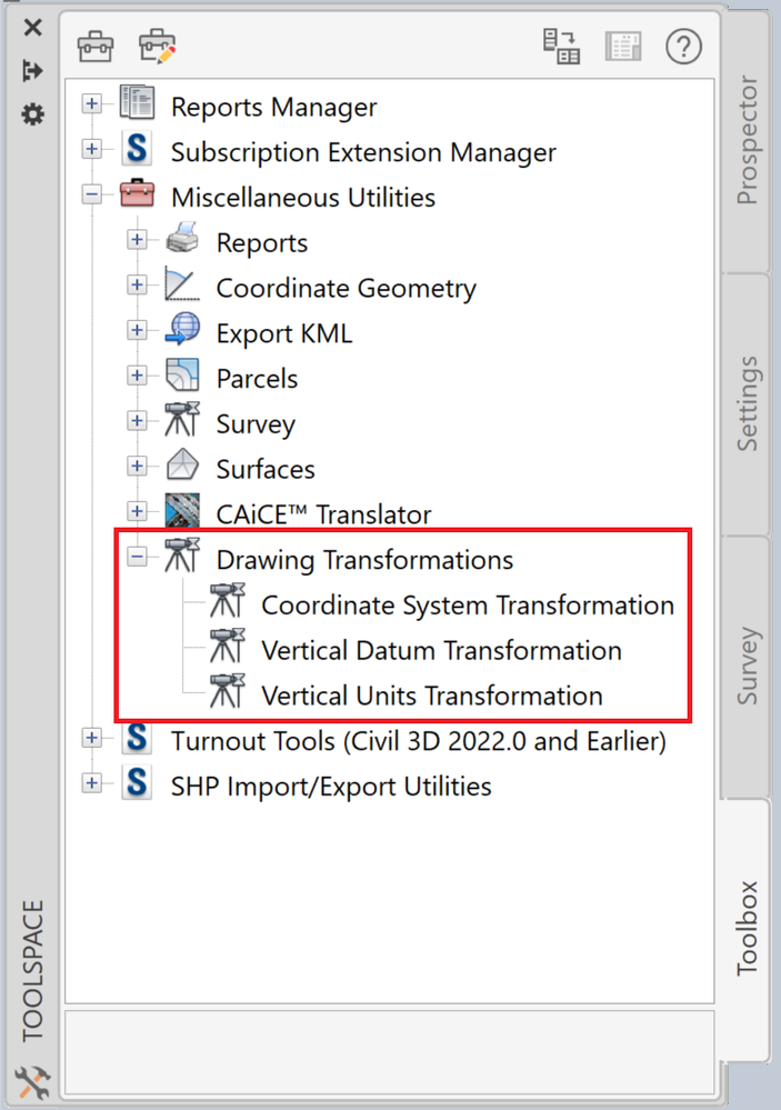

Actually, there is. You could create a Custom Affine Projection and then use the new Drawing Transformations Tool. I've tested it a bit, and it seems to work. The Vertical Units Transformation only seems to work for Geoid Versions, not NGVD27 and NAVD88. The 11th hour is probably not the time to be diving down a rabbit hole.

krzysztof.kozakDX266
@Pointdump
Also, I don't have what you show in my Toolbox.
Message 14 of 16
AllenJessup
2022 with the latest updates should have it.
https://knowledge.autodesk.com/support/civil-3d/learn-explore/caas/CloudHelp/cloudhelp/2022/ENU/Civi...
Allen Jessup
CAD Manager - Designer
Message 15 of 16
Pointdump
And I sure don't have what is in your Toolbox. 🙂
Look for "Coordinates Transformation Tool 2022 for Autodesk Civil 3D" on the Product Updates tab of your Account Page.
