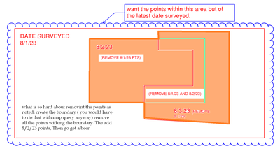

Is there a way to create query points based on location and date imported?
bill2NMLX
What going on I have is three groups of points that were each imported on progressive days. We now have polyline boundaries around each date. But these points have some overlap from day to day with older points.  We would like to create a query or pt group of the latest points and only get the newest points ignoring the older ones that the newer ones overlap.
Is this possible in C3D using either a map query or maybe even programing with Dynamo? Any ideals of things to try would be greatly appreciated.

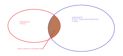

Message 2 of 25
Joe-Bouza
Caveman approach: create the venn diagram of point group A and Point group B
Display the two boundaries and Point Group A. Change or remove the points in the overlap
If that were pseudo code I would say yes it can be programed

Joe-Bouza
This is how I understood the question. Is this not correct?
Joe Bouza

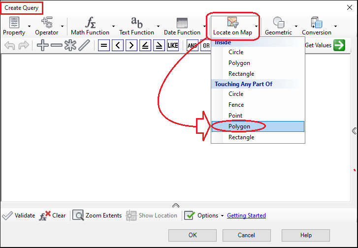

Joe-Bouza
I assume these are civil3d cogo points? I do not think MAP queries apply to civil3d object but they do to shp and or sdf files.
you can export cogo to sdf then query by area.
Looking  at you diagram it looks simple enough to caveman... either way the query has to be given the boundary to omit. Which IMO would complete the task ala caveman.
I don't meant to over simplify your task ... the answer to query is YES it can be done

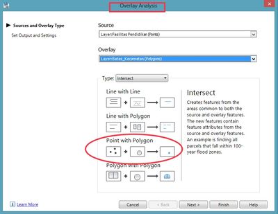

ChicagoLooper
@bill2NMLX wrote
<<…I have is three groups of points that were each imported on progressive days…>>
 And
<<…We now have polyline boundaries around each date...>>
You can use Overlay Analysis from the Planning and Analysis workspace. (Map3D Toolset, Analysis Tab.)
Create three point shapefiles, one for each survey. You have 3 surveys, correct? And create a polygonal shapefile for for the polyline boundaries. They are ‘closed’ polygons, correct?
Add the shapefiles to a your drawing. Next, overlay a point Feature Class (shapefile) with the polygonal feature class to perform an overlay.
The result will be an SDF file where the two shapefiles overlap. You can keep the resultant SDF as is, or you can use MAPIMPORT command to turn the SDF into plain vanilla AutoCAD entities. The resultant SDF will contain data from both point and polygonal feature classes.
You’ll need to perform a separate overlay for each point shapefile unless you combine all three groups together and add a Date of Survey field to differentiate the groups.
Chicagolooper

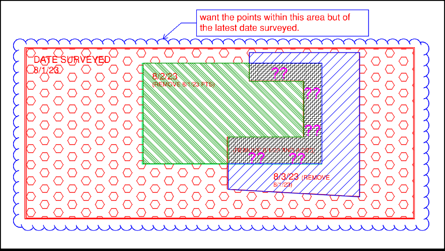

Message 13 of 25
ChicagoLooper
@bill2NMLX
Your uploaded image is confusing. You can easily REDRAW the 'areas' of interest where you can include points you want and exclude points you don't.
Red=Points dated 8/1/23
Green=points dated 8/2/23
Blue=Points dated 8/3/23
The confusing part, based on your parameters which you described in red, is the black zigzag hatch area. Do they belong to the green or the blue group? Whatever, whatever. Your boundaries can easily be adjusted--they're plain vanilla polygons.
You can make three separate point shapefiles; one for each date. Then you can query based on location.
The result will be the points that are only inside the boundary. Since you mentioned you have three groups of points that were each imported on progressive days, you can make a separate shapefile for each group where each group represents a different day. You can query using any polygon and the query will only 'capture' only points falling inside the boundary.
If you delete the query for any reason, you can draw a new polygon and query the new one.
Chicagolooper
Message 14 of 25
Joe-Bouza
seemed to me any points before 8/3 in a composite boundary are to be removed.
