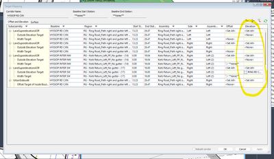

I have an intersection, I am trying to get the elevations correct, and I cant seem to figure it out.
I have created a feature line with the correct elevations that I want the top of the kerb return fillet to connect to, and I want the inside edge of the road to have the same elevation as the horizontal connection. however it is sticking up very high.
Please see the images so you can see what I am talking about.
As I read my question, I am confusing myself, I am not even sure what to ask help with.....
The horizontal connections are correct for this intersection, however the inside edge and outside edge are both very high.  I dont know how to bring them down.  I have created the pink feature line, that would be the correct height for the back of kerb, however when I set this as the elevation target, only the inside of the kerb return fillet comes down. The below image is the cross section view of the area im in.  The side on the right is the main road, and the side on the left is the intersection (or kerb return fillet) coming into it. I need the inside to come down a little bit to connect to the main road, and I need the outside edge to drop down so I have a 2% grade from the kerb to the center of the road:-
I hope this question makes sense...

Is the profile the radial return? Set a new profile and have the Kurb target that profile.

Hi Vincent Thank you for persevering with that horrible question.
I am not sure what a radial return is sorry. I have 2 profiles in the area, number 1 in the picture below is the main road, the levels and the level of that profile is correct.  Number 2 in the image below is the intersection.  The profile is correct, but the kerb levels, or the outside edges are too high.
In the image below, I am hoping to bring the outside edge (where I have drawn the blue line) down to the level of the pink feature line that I have shown with the red arrows.
I thought I would be able to set the elevation to that feature line using the target mapping, however, there is no way to set the back of the kerb to target the feature line separately from the inside (or middle of the road).  If I target that feature line, only the middle of the road drops down, the back of kerb does not change.
I think I have made what I am asking for help with a little more clear now.
Hopefully this is a sensible question now.
Thank you,

I agree, it’s tough to follow. AFAIK, The top of curb for OOTB sub does not have a vertical target.
I had success building  a curb from generic links to control to top of curb

Maybe instead of using a feature line, Try offset alignments, coupled with connected alignments?
