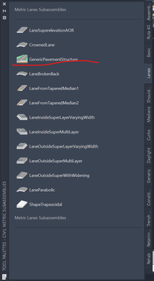

Hi @s.sajjad.jafari, in the case of points, open the tool palettes and go to the generic tab. Look for the MarkPoint Subassembly and assign it to your assembly. It allows you to set the code of your preference
In the case of links. In the same palette, you have the LinkWidthAndSlope Subassembly which allows you to set a point and link code. If you want a lane, look for the generic pavement structure
This generic pavement allows you to control point, link, and shape codes.
