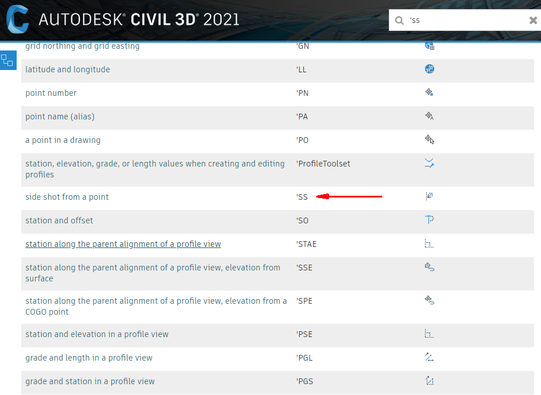

'SS is a defined transparent command in Civil 3D. You can't overwrite it.
https://help.autodesk.com/view/CIV3D/2021/ENU/index.html?guid=GUID-EF0CF764-A621-4B2B-B3FB-2B8A29E86881

Well that's a bummer.
Thanks for the info, at least now I feel less crazy.
