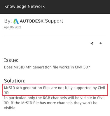

Not all sid files are supported.
How are you bringing in the sid file? Are you using Raster Design, a civil3d command or the Data Connect Palette?
You can read the knowledgebase >>HERE<<.
