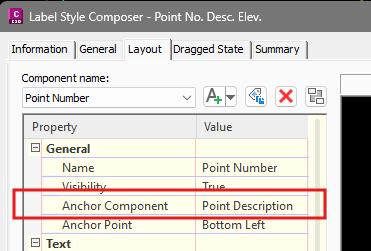

How would one delete a text component, such as Point Number, from the drop-down list? I am attempting to make a point style that only shows the elevation and descriptor. When I select Point Number, I am unable to delete it.

It could be that the point number text component is being used as the anchor for another component.  Check the other component's anchor objects.

Don’t try to Delete it, just change its Visibility.

when you select it, push the red X on the right of the list 🙂

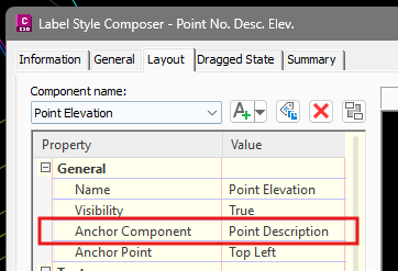

How would I go about checking the component's anchor objects?
chriscowgill7373
if you look at the other elements, it will tell you what it is attached to
Everything is anchored to the Description, except the description, it is anchored to the feature
