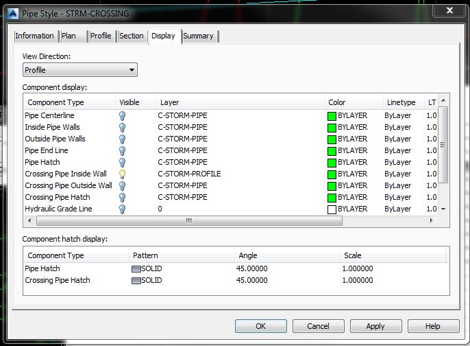

I made the changes you suggested and the pipes show up now but not as ellipses.  I have included screen shots to verify that I did everything correctly.Pipe not showing as ellipse.JPGPipe not showing as ellipse PV.JPG
Message 8 of 20
civilman1957
You have to change the style of the pipe. If it's a crossing pipe, it has to have its own style. In that style, you're display in profile view should have everything turned off except "crossing pipe outside wall". That will show an ellipse where your crossing pipe crosses the main line.

We have a crossing style and that is what it was originally on.  I have been changing everything I could think of to make them show up so I probably hadn't changed it back.  When I check the "Show only crossing pipes" box the pipes don't show up anymore so maybe they aren't crossing but then again why are they in the original file?  They are pipes 135 and 136.4.JPG1.JPG2.JPG3.JPG

Jay_B
Try this.
In your screen shot, assuming pipe 135 is one of the crossing pipes, uncheck "draw" column, go to that structure number & edit structure style > Display tab < View Direction: Profile > Structure Pipe Outlines > on.

Message 13 of 20
That worked. Thanks
