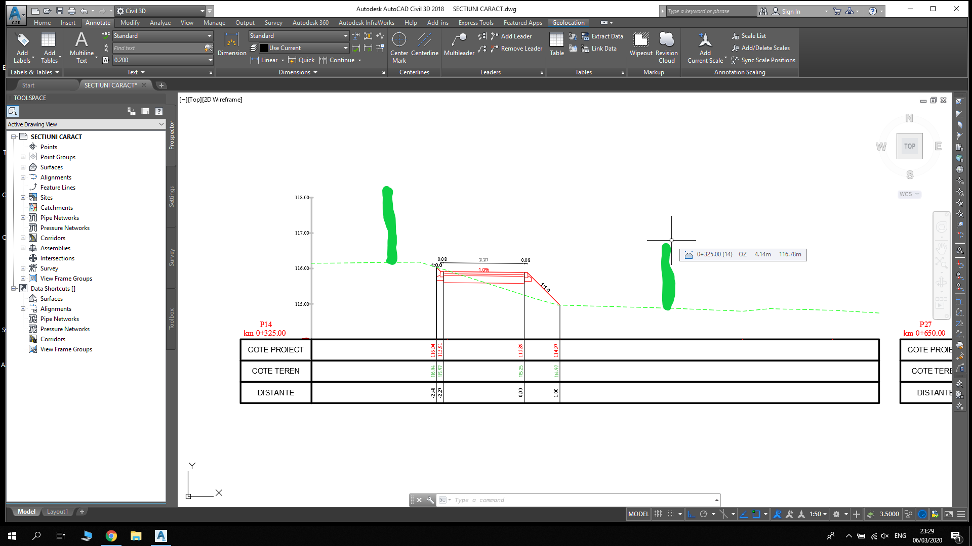

How can i get the same result like în this video.
https://youtu.be/ECIFoHop3dM
The a notate above the section and the band labels, where are eg ELEVATION, coridor ELEVATION and offset distance. I mean for example, for ETW to represent the eg ELEVATION, Project ELEVATION and offset, all for same Point.

I was partially Succesfull, only for finished ELEVATION and offset. I don t know how to represent the ground ELEVATION...

If I understand right to show ground elevation you need to change surface that represent specific label from Section View Properties>Band tab and then Section1 or Section2

i attached 2 photo, as u can see in bands that is the result, only offset and FG are where i want, and EG is on major cause i can t figure how to represent in same points..
And i draw something, how can i represent limit propretry and road alignment in section view?.
i put the dwg format, maybe some1 can help me.. i spent 2days and i don t know ho to do it... ty !

i import my band set in your cross section as you can see in attached drawing. But if you want to work correct corridor section must be on sample line in order to surface triangle create on sample line. Also delete all triangles outside boundary line.( And just change the language 😄 )

This errors depence of FG surface. Your FG is not create until boundary of corridor. you have more triangles outside as you can see on attached photo. You can delete triangles from surface and will work ok.Becouse FG surface control Band set.

It is not necessary to delete manually each triangles. After creation corridor create Top Surface from top links of your corridor and program will recognize where is the boundary. If still you have more triangles behind boundary go to surface properties >definition tab> build> maximum triangle length and set to for example 10m.

Now i have one problem. how to project a fence (property limit) on section view. I have a polyline wich represent the property limit, any idea how to do it?

in  plan photo u can see a green line wich represent the proprety limit(fence), in cros section photo i draw a green line, how i want to represent the fence...it s posible?
in 1st post in that movie u can see on both side how is represent...

Yes it is possible. Create assembly just with surface link and assign left and right point code ( for example "fense"). start to create corridor and use offset target your polyline.  When you create corridor import coridor in section view and control left and right point code by Code set stile.
