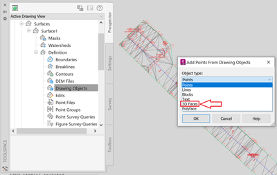

3. In Civil 3D, create a surface by adding the 3D Faces.
4. Import point file from the QGIS vertices extraction.

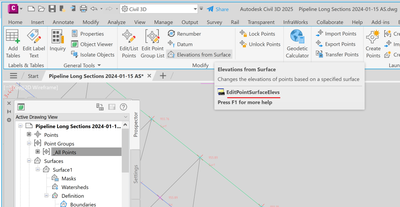

5. Assign elevations from surface to the COGO points.

Use command QSELECT to see what sorts of objects are in your drawing. The Blocks in your drawing also had useful elevation data, but the 3D Faces covered the entire project, so I used them.
In Prospector, right-click Surfaces and select "Create Surface..." to create a new TIN Surface. In the new Surface, under Definition, right-click "Drawing Objects" and select 3D Faces. (Click on "Maintain edges from objects") To assign surface elevations to your COGO Points, use Modify>>Points>>Elevations from Surface.
