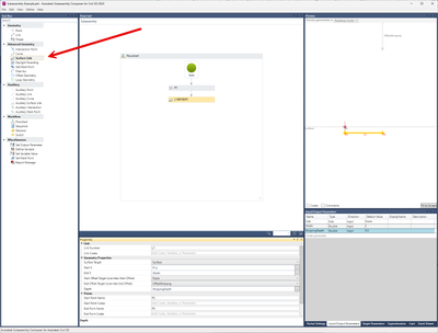

Hello Everybody,
I want adding the stripping for the pkt attached, if you want help me.
Thank you.
Accepted solutions (3)
995 Views
cyberflow
Hi @bgalleze
You'll have to use the "Surface link" component in SAC
Before adding that you'll need to create a few things :
Add a starting point
Add a target surface (For targeting the surface you'll want to strip)
Add a Offset target to target the offset of the stripping
Add Input parameter for the width of the stripping if your not using any targets
Add Input parameter for the depth of the stripping if you want to control the depth of it
I've attached an example
You can go to on the Autodesk site to download the sample of PKT they have
https://www.autodesk.com/support/technical/article/caas/sfdcarticles/sfdcarticles/Sample-PKT-files-f...
There you can open their examples and learn a lot from there !
Good luck !
P.S. I noticed that .PKT files can't be attached on the forum, they need to be zipped so that they can be attached.
