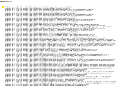

For a parking lot design with irregular curbing, I created a corridor for curb/gutter/sidewalk, around 3 sides of the lot, using assemblies and regions (file attached). Can anyone suggest how I might fill in the area between the curb corridor with a paving surface? I considered offset assemblies to a centerline feature line, but, since this lot won't have a centerline crown, the paving needs to go from curb flange to curb flange, which are actually the same point on the same assembly, from either side of the lot. Any suggestions would be great. Thanks!

First you need to fix the baseline errors
You do not need to extract FL. because of the base line errors I couldnt see how the surface is constructed. If you choos FL and choose the codes for flange, bc, tc.... it should triangulate across

Thanks Robert and everyone for the potential solutions. Extracting the gutter flange feature lines from the corridor worked best for me. I couldn't then create and infill grading since the corridor feature lines didn't form a closed polygon, and adding feature lines to connect and form a closed polygon wouldn't work, I then created a new surface and added the corridor feature lines as breaklines, which worked. Thanks
