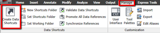

troma
I've never seen that box before.
Here's what I was talking about:
Mark Green
Working on Civil 3D in Canada
Message 8 of 12
Well, I couldn't find the "Manage" in the ribbon.  However, I did create the data shortcut in the file and it added an XML file in the working folder for data shortcuts.  I was able to add that in the file I want to work in, so the problem in solved now!
-In the pipe file I went to Toolspace - Data Shortcuts (Right Click) - Create Data Shortcuts.
Then I checked the working directory folder and that created the XML file in the pipe network folder, then went to my active file and it's in my data shortcuts tab in the prospector.
