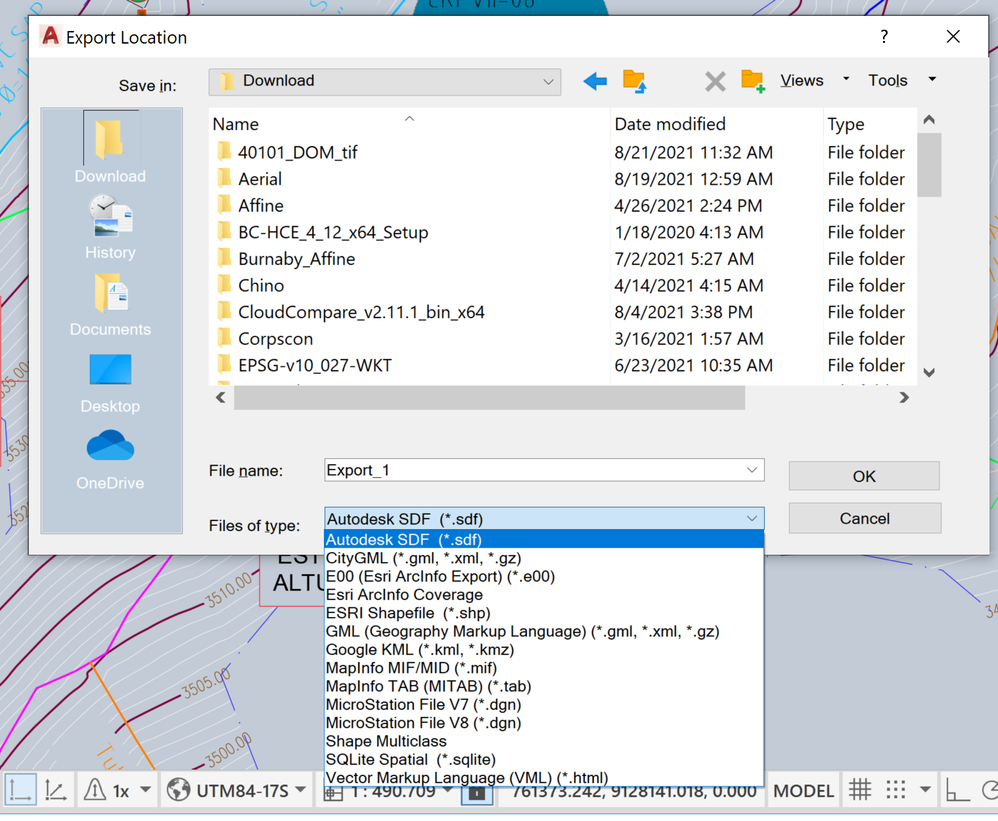

No doubt you're right, but where is the FGDB Export Function? GDB doesn't seem to be a format option with MAPEXPORT.

@Pointdump if you are still looking at how to do a GDB export, see photo below:
