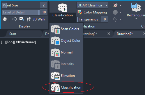

So you're dealing with LiDAR and you have also used Recap.
You have been provided with classified points for ground and vegetation, correct? I'm guessing you have differennt classes for ground and vegetation. Pavement vs grass? Low bushes vs. high trees? If this is true, you can try this.....
Instead of using Recap to 'convert' to dwg format, use Recap and perform a Save As to .rcp format. Then back in C3D, go to Insert Tab=>Point Cloud Panel=>Attach button=>Browse to and attach your .rcp.
After a few seconds (or minutes) you'll have your rcp in modelspace. Next, select your newly inserted rcp file and you'll get a 'contextual ribbon' pretaining to your rcp. Go to Visualization Panel=>Classification button. See image below.
