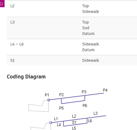

I'm trying to set my LINK labels in my code set style for my cross sections however I'm getting much more than I want. I set the same label style for both my Pave and Sidewalk links. All I want to see is the slope% just like the Pave 2%. I'm not understanding why the sidewalk is giving me the "Vertical" label as well as the additional lower 1%. The style properties of the label are Link Grade. I have tried others but get the same results.
Is there an easy way to remove the extra labels or is this part of the code labeling of the sidewalk subassembly?

I went ahead and switched to a custom sidewalk SA that I have, and my label picked up the top link only. I'm still not sure how this works for labeling and if anyone can enlighten me, I would appreciate it.
Jeff_M
Look at the help file for the subassembly. It shows which codes are assigned to each link. The programmer for the Urbansidewalk decided to use Sidewalk for all 4 sides of the sidewalk, unlike what was done for other subs.

Thank Jeff. Makes sense. I'll assume in the SA composer I can remove the extra link codes for Urbansidewalk? I have not done any editing on SA's so I'll walk with caution.
