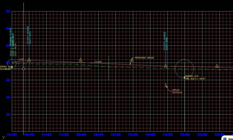

The update that was released this week, 2018.3, has some issues. Same issue that was fixed in an earlier release by replacing the AeccLand.dbx file. Weird anomalies in the profile...

We have the same situation showing up in 2018.2 with the FG PI Markers showing up all over the place when we use the create sheets. They also appear when you create split profile with out plan production.

Autodesk has a new hotfix for the Profile problem.
  1. Close AutoCAD Civil 3D 2018
  2. Go to C:\Program Files\Autodesk\AutoCAD 2018
  3. Rename the existing AeccLand.dbx to AeccLand.dbx.OLD
  4. Download AeccLand.zip file from within this article
  5. Extract the AeccLand.dbx file after downloading
  6. Copy/Paste the attached AeccLand.dbx into the folder C:\Program Files\Autodesk\AutoCAD 2018
  7. Restart Civil 3D 2018
Zip file is attached.

I just got this hotfix from Autodesk support for the issues with the 2018.3 update.  So if you are having problems after loading that update you will need this hotfix.  We tried the old one since the problem was the same and it didn't fix the problem.  However this one is a new hotfix for the 2018.3 version and should fix your problem.

The issue with the 2018.3 update we had was when you have a split profile view the profile PVI markers would display beyond the end of the view and not in the proper place with the view.  Loading the Hot Fix took care of the issue.
