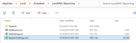

I got that error earlier. I then tried to change the report settings which came up with a blank form. I found this file was missing from C:\Users\jeffm\AppData\Local\Autodesk\LandXML Reporting
I copied the stock one from the Support folder and all was well.

@neilyj666 mine was in the same folder as shown in my screenshot. It appears yours is not... If you have access to the installer files for Civil 3d 2025, you could copy the support folder from there. This is where I saved the installer for 2025:
D:\Autodesk\2025\Civil 3D 2025 - English - (EN)\x64\en-US\c3dps\PF\Root\PF32\Autodesk\LandXML Reporting 8\Support
