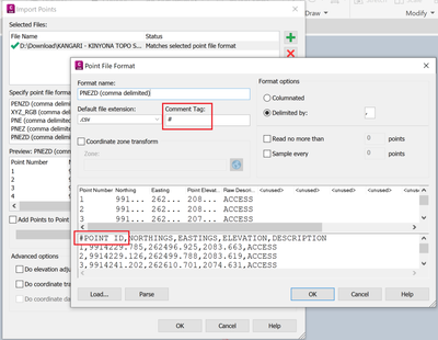

Todd @ToddRogers-WPM makes a good point about the header. I like headers because they tell you how the point data is arranged. So I add a "#" at the beginning of the row. That tells Civil 3D to ignore the first row.
CSV file attached.

Worked Like a charm.Thanks alot @Pointdump
