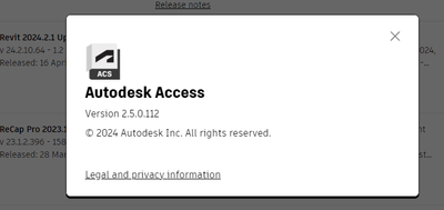

Message 6 of 8
neilyj666
@brian.strandberg How does Access get updated?

Message 7 of 8
brian.strandberg
You can download a new version here: Autodesk Access | Formerly Autodesk Desktop App | Autodesk  (download button towards the top). What I found is once I applied the AllowSystemContextInstall registry key, access updated on its own.

Message 8 of 8
brian.strandberg
@neilyj666, You can check what version is installed from the command line via this mini Powershell command.  I run this from our IT software to check if people are getting the update.
powershell -command "Get-Item -Path Registry::HKEY_LOCAL_MACHINE\SOFTWARE\Autodesk\ODIS
It will return this (or similar).  From this I can tell this user can install their own updates.  (They have access 2.6+ and have the allowsystemcontextinstall registry key)
