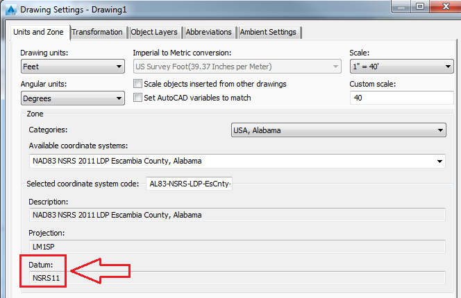

Playing with Low Distortion Projections in Civil 3D 2016. I made one Map Projection with a Reference Frame of NAD83. I Duplicated it and Edited ONLY the Reference Frame to NSRS11.
In my drawings with the NAD83 LDP, I'm able to Attach and Query other drawings, and use Bing Live Maps without any problem whatsoever.

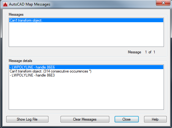

But in my drawings with the NSRS11 LDP, Transformation is wonky. I can transform objects from the NAD83 LDP drawing OK, but when I attempt to Attach a drawing in Can27-Ont16 or LL83 to the NSRS11 LDP drawing, I get this:
If I "Clear Messages" and go ahead and Attach and Query a drawing in Can27-Ont16 my objects land about 500 miles North of where they ought to be. And Bing Live Maps won't work at all with any NSRS11 drawing I've tried. In the command line I get, "_geomap No geographic location defined".

Step 1. Open Alabama TriCounty2016_NSRS11.dwg. Notice that the assigned coordinate system is a Custom Projection in the NSRS11 Datum.
Step 2. Attach US-StatePlanes-LL83.dwg. Query "Location:All". Draw and Detach. Not only has the first drawing failed to transform Drawing 2, but also, Bing Live Maps refuses to work.
Every way I've tried to use NSRS11 has failed.

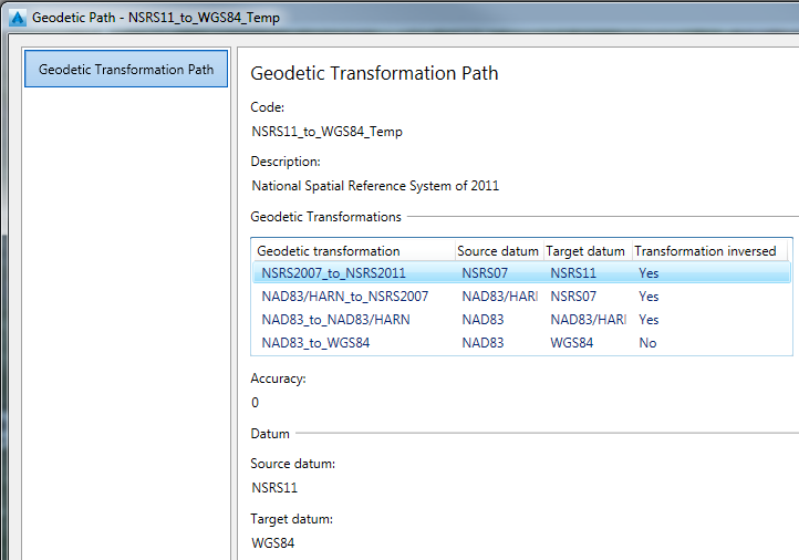

OK, I think I see something. After testing by attaching several drawings to my custom projection in NSRS11, my only failure is trying to attach "US-StatePlanes-LL83.dwg", a drawing in LL83 Geographic Coordinate System. So transformations work now for Projected Coordinate Systems, and Bing Live Maps comes in the right spot.
The new definitions loaded fine:
What does "Transformation Inversed" mean, and why does "NAD83 to WGS84" say No?

That is great news!  "Transformation Inversed" means that the transformation works from the target datum to the source datum as well as the source datum to the target datum.  My guess as to why "NAD83 to WGS84" says No is that because there are transformations and/or paths from:
NSRS07 to/from NSRS11
NSRS11 to/from NAD83 HARN
NAD83 HARN to/from NAD83
and NAD83 HARN to/from WGS84,
so a path from WGS84 to NAD83 is not needed.
I hope that makes sense!
