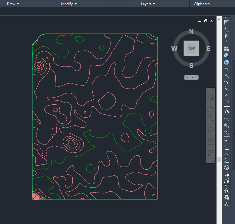

Hello everyone, I followed step by step the right procedure:  1. Create surface from GIS data 2. Data source type: SHP - I selected the shp file from my library and then I selected "login" - I flagged the shapefile and I can check that the shapefile is assigned with the right coordinate system 3. I removed flag on "define area of interest" 4.  I assigned the elevation Civil3DProperty to the right GIS field. When I click on "finish", it pops up an error "NO GIS DATA TO IMPORT": I can import the shapefile to ArcGis without any problem, so it isn't a shapefile problem   I don't know what to do.. thank you for listening to me,  Giulia

Typically, GIS data in the form of Topographic Contours or Points are used to create a surface. <<Your data may vary.>> Somewhere, someplace you are missing a step OR performing a step incorrectly.
1. Begin the surface creation procedure.
Image-1Image-1
2. Give your surface a NAME. (Optional: Give your surface a description.)
Image-2Image-2
3. Browse to and select your contour shapefile. This example uses a topographic contour shapefile.
Image-3Image-3
4. Check the box next to the Feature Class (contour line shapefile).
Image-4Image-4
5. You may, or may not, decide to check Define area of interest by which will LIMIT the data you'll use to generate the TINN surface. If you don't check the box, C3D won't limit and will use ALL the data even if the data covers more the the target TINN area.
Example: You use 100% of the data even though you only need 8%, this means you have 92% EXTRA Tinn surface that you won't display in your viewport but generated anyway because you chose not to 'limit the data.'  Devoting resources to create a TINN bigger than what than what you'll display in your VP is  not efficient Cad management.
Image-5Image-5
6. This is where you to tell Civil 3D how to RAISE each contour to its proper elevation. By default, contour shapefile using this Civil 3D procedure will be at 0-feet (mean sea level) despite the GIS data indicating it has an elevation value. The GIS value is for informative purposes only, meaning the values look 'nice' when viewed in a Table.  It doesn't mean your contour is PHYSICALLY elevated above sea level! You want (the C3D creation process wants it too), contours that are 'raised' up to their corresponding elevation so the surface creation process can create a TINN with proper elevations, not a flat surface at sea level. Don't get me wrong, DATA values (any data values) in a Table are NOT useless or meaningless. When used with know-how can perform analytical functions beyond the scope of Civil 3D.
Image-6Image-6
Performing 1 thru 6 correctly will create a TINN.

I had no problem creating a surface from your uploaded shapefile so I can't say Civil3D's process is flawed. It might be (or might not be) user error. Make sure you HARVEST the correct elevation values from the shapefile's database file (dbf). The mechanism to harvest the elevations in the Create Surface from GIS Data workflow is called Data Mapping. (Refer to Data Mapping in image below.) The harvesting process is built into the workflow and is shown highlighted in blue.
The attribute in the shapefile you need is named ELEVATION. See Left column. This attribute will be used by Civil3D as an 'definition' for your surface. Mapping the elevation is Civil3D's way of saying, 'OK, thank you for letting me know where to get the data.....now what do you want me to do with those values?' The Right column says, 'Mr. Civil3D, you're welcome, now please use those attributes as surface ELEVATION when you build my surface.'
The procedure already knows which attribute value corresponds to which individual contour line. With proper Data Mapping the shapefile's database is leveraged to build you surface using the correct elevations.
NOTE:
FYI, I don't think UTM84-32N is the correct projection because your contours do NOT land in Italy. Turn on Bing Hybrid and you’ll
see your contours are too far east compared to Bing.
Is your site Motta Visconti? I don't believe the author of the shapefile used UTM84-32N.

Make sure your shapefile is using the native coordinate system given by the shapefile's original author. Use Monte Mario / Italy zone 1. Refer to Image-1.
 Image-1Image-1
You also wrote:
<<... even if I assign the "elevation" field to the shapefile field, I still get an error...>>
The shapefile's elevation values are stored in the DBF (database file). Refer to Image-2.
Image-2Image-2
Before building your surface, use the command MAPCSASSIGN to assign UTM84-32N to your drawing's modelspace. Add your shapefile named contour_line_2 after you've established the drawing's CS.
It's perfectly OK for your shapefile to use its native CS (Monte Mario/ Italy zone 1) while your modelspace has UTM84-32N.
Casorate Primo, correct? Refer to Image-3.
Image-3Image-3
