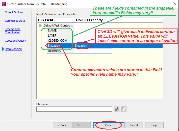

6. This is where you to tell Civil 3D how to RAISE each contour to its proper elevation. By default, contour shapefile using this Civil 3D procedure will be at 0-feet (mean sea level) despite the GIS data indicating it has an elevation value. The GIS value is for informative purposes only, meaning the values look 'nice' when viewed in a Table.  It doesn't mean your contour is PHYSICALLY elevated above sea level! You want (the C3D creation process wants it too), contours that are 'raised' up to their corresponding elevation so the surface creation process can create a TINN with proper elevations, not a flat surface at sea level. Don't get me wrong, DATA values (any data values) in a Table are NOT useless or meaningless. When used with know-how can perform analytical functions beyond the scope of Civil 3D.
Image-6Image-6

I had no problem creating a surface from your uploaded shapefile so I can't say Civil3D's process is flawed. It might be (or might not be) user error. Make sure you HARVEST the correct elevation values from the shapefile's database file (dbf). The mechanism to harvest the elevations in the Create Surface from GIS Data workflow is called Data Mapping. (Refer to Data Mapping in image below.) The harvesting process is built into the workflow and is shown highlighted in blue.
The attribute in the shapefile you need is named ELEVATION. See Left column. This attribute will be used by Civil3D as an 'definition' for your surface. Mapping the elevation is Civil3D's way of saying, 'OK, thank you for letting me know where to get the data.....now what do you want me to do with those values?' The Right column says, 'Mr. Civil3D, you're welcome, now please use those attributes as surface ELEVATION when you build my surface.'
The procedure already knows which attribute value corresponds to which individual contour line. With proper Data Mapping the shapefile's database is leveraged to build you surface using the correct elevations.

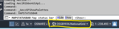

neilyj666
I'd also recommend enabling the MAPSTATUSBAR in Civil 3D so you can see where you are in the world

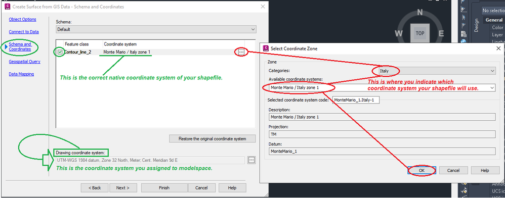

@giulia_lussanaAWHRM
Make sure your shapefile is using the native coordinate system given by the shapefile's original author. Use Monte Mario / Italy zone 1. Refer to Image-1.
 Image-1Image-1

Before building your surface, use the command MAPCSASSIGN to assign UTM84-32N to your drawing's modelspace. Add your shapefile named contour_line_2 after you've established the drawing's CS.
It's perfectly OK for your shapefile to use its native CS (Monte Mario/ Italy zone 1) while your modelspace has UTM84-32N.
