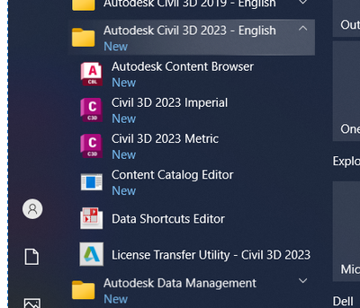

I don't have that option under start, see pic.

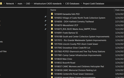

If you're talking about the reset setting in Profile Tab under options, there's a setting in there to reset, but why would I reset everything just because the Data Shortcut Working folder doesn't hold in 2023? This would reset all of the pathing's to the default C:\. We house our plotters, plot styles, pipe catalogs etc.. on the server, so clicking on the reset would take all these Network server paths back to C:\ in options.
There may be some confusion here, but I don't have a problem setting the loadrecentdsprojectstartup back to OFF. That's done.
I'm assuming you're using Civil 3D 2023. When you open a different project drawing, does your data shortcuts change to that project automatically?
We have a unique setup here which has always worked thru multiple versions until 2023. We have a Project Cadd Database folder which is set as the Working Folder. We only store the Project Data Shortcuts here under their respective project folder. In version 2019, I could switch to 30 different projects in 1 day and the correct Project folder comes up correct 30 times.

spear_kevin_pe
Yes, Windows 10 & 11 do not show all apps in an app folder. You have go to the old program folder (C:\ProgramData\Microsoft\Windows\Start Menu\Programs\Autodesk Civil 3D 2023 - English) to see the full list.
In that folder is the reset tool to cleanup your profile. If you have a custom profile, you need to export it first. When using the reset tool, it cleans up the local user, launches vanilla autocad. Let it completely load. THen close it. THen launch C3D - imperial first. Test your DS scenario there before reimporting your profile. Make sure it works without customizations.
