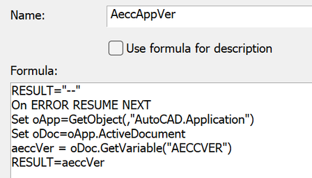

Message 17 of 32
Jeff_M
@cyberflow  To minimize the amount of maintenance to PropertySet VBScript code I have devised a method which is working well in my initial testing. It involves having an Autoloader bundle which creates a new Sysvar "AECCVER" which is saved to the Registry and is accessible by all users on that computer. There is one entry per C3D Release in the PackageContents.xml file. Once the AECCVER Sysvar is set then the VBScript code never needs updating when using these PSet definitions:

Message 18 of 32
Jeff_M
Attached is an autoloader bundle which creates the proper AeccVer sysvar for C3D2020-2025. This would be the only file that would need to be edited for future release support. I suggest placing the bundle in the C:\Program Files (x86)\Autodesk\ApplicationPlugins folder.
