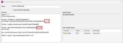

Hi all,
I'm in the process of update my code that worked fine with my C3D 2023 and now adding the code to cover 2025 i've received error messages "PLN is null or empty)" :
I've always found that VBscript always execute oddly - Might be an impression or i'm just really missing something here ...
I've adjusted/added lines 14 to 18 :
Dim oCivilApp, oDocument, oPipeNetworks, oPipeNetwork, oPipe, oNetworkObjectID, found, InputHandle, sPipeNetworkName, sAcadVer
Dim fs, logFile, sC3DVer
RESULT = "--"
On Error Resume Next
InputHandle = "[Handle]" ' Replace with the actual handle you want to search for

@cyberflow You seem to have a better grasp of teh VBScript than I so maybe you can find a way  to make this work. The following is what I have tried, without success. This is pretty much identical code (to get the current AeccApplication) that I use in many .NET, COM based, tools.
RESULT="--"
Set oApp=GetObject(, "AutoCAD.Application")
Set oCivilApp=New AeccApplication()
oCivilApp.Init(oApp)
Set obj=oCivilApp.ActiveDocument.HandleToObject("[Handle]")
RESULT=obj.Name
I have used this method for many years, yet I sure can't get it working with the Psets.

Anton_Huizinga
This:
Is not recognized. Maybe VBScript is too limited, compared to VBA.
In the end, I think my original idea of creating one formula property that returns the correct reference, will be an acceptable workaround. Then with a new version, only one formula property per drawing needs to be changed.

Anton_Huizinga
It could be possible to split the result and get the major and minor versions. But I'm not sure if this information is also translated in other languages. It looks something like this:
Get the third line, split on semicolon, remove spaces, split on point, combine the first two values (13.7).
But this value is only valid for the Aecc parts. If you want to use, e.g. convert functions from the AecBaseApplication, that has a different version number:
Which I had described in my blog: https://blog.huiz.net/2024/11/30/dynamische-of-statische-property-sets-in-civil-3d-1/
