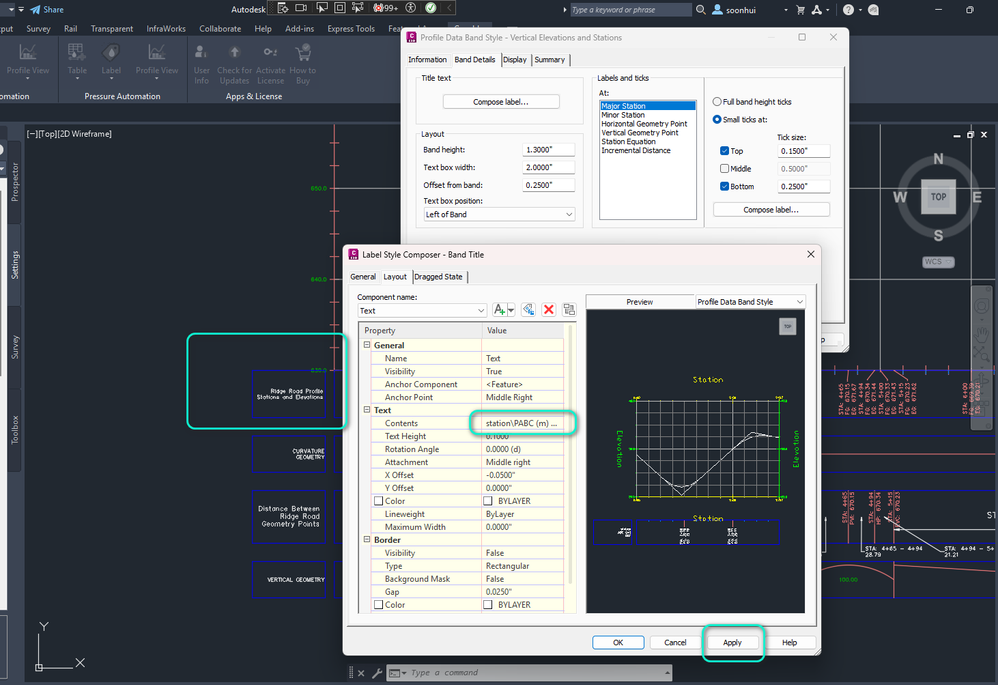

I'm pretty sure this is a bug in Civil 3D: I found that when I update the content value in LabelStyleTextComponent , the UI is not immediately updated as it should.
You can use the attached drawing, and the following code to test.

To update it, you will have to click Apply on the Label Style Composer, as shown below, then it will be automatically updated.

michal_hcz
hi,
Autodesk.AutoCAD.Internal.Utils.FlushGraphics(); did not help but ed.Regen(); works fine. Not the best solution but at least somenting 🙂

michal_hcz
Yes, the prohlem is still here.
Latest C3D 2026, your DWG.
After your command:
After ec.Regen():
