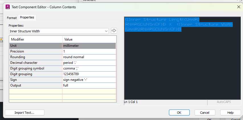

Edit the text Component Editor value via .Net
soonhui
For the below case, the value in the Text Component Editor is
<[Inner Structure Length(Umm|P0|RN|AP|GC|UN|Sn|OF)]> X  <[Inner Structure Width(Umm|P0|RN|AP|GC|UN|Sn|OF)]>
But is there anyway that I can edit that value via .Net code?

soonhui
Thank you, @hippe013 , that really works for LabelStyles because we can reach the relevant LabelStyleTextComponent via what your code.
However, I found that there is no way to reach the LabelStyleTextComponent via Table Styles, as shown in the screenshot below:
Somehow I can get the TableStyle via the below code, but there is no related Data Properties that is exposed, see the API list here.
 Document aDoc = Application.DocumentManager.MdiActiveDocument;
 Editor ed = aDoc.Editor;
 Database db = aDoc.Database;
 CivilDocument cvlDoc = CivilApplication.ActiveDocument;
 StylesRoot styles = cvlDoc.Styles;
 ObjectId styleId = styles.TableStyles.StructureTableStyles["@StructureTable"];
 using Transaction tr = db.TransactionManager.StartTransaction();
 var style = tr.GetObject(styleId, OpenMode.ForWrite) as Autodesk.Civil.DatabaseServices.Styles.TableStyle;
Any thoughts?

hippe013
@soonhui, drilling down into the components of a table style is quite different, and even more so for a structure table style or an alignment segment table style, according to the API documentation.
I can see in your image that you are looking at modifying a pressure pipe table style; however, my current example code is specifically for a structure table style.

        structColmCompData.Content = "<[Description(CP)]>";
        colmStyle.SetComponents(structColmComp);
        // Print changes made to the component
        ed.WriteMessage("\n" + $"New Component Data (Name / Content): {structColmCompData.Name} | {structColmCompData.Content}");
        tr.Commit();
Note that I use the Basic style for the Structure Table.
You can use another drawing but I suspect the result would be the same.
To solve the problem, you need to "manually update" the column value in the UI by click on "Edit Table Style", select the related column, then click into it and click OK until you go to Text Component Editor, and then click OK ( no need to change anything). Then click apply. Only then the table rendering will be updated.
