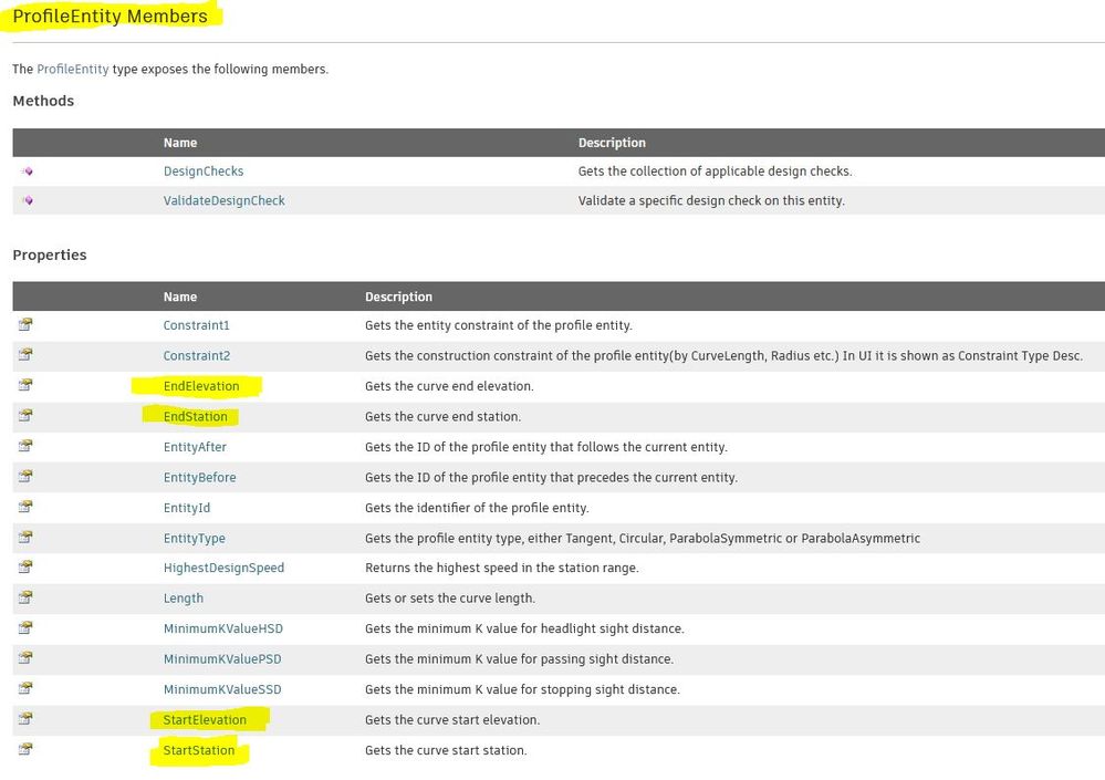

HI ... TRY
1-GET Polyline FROM Alignment WITH   GetPolyline
2- Creates a FeatureLine from the Polyline WITH  Create(String, ObjectId)
3- Set an elevation to existing Feature Point FROM profile  WITH        SetPointElevation
4- Inserts a PI point along the FeatureLine FROM  (profile entities  WITH   Entities  ) WITH InsertPIPoint
