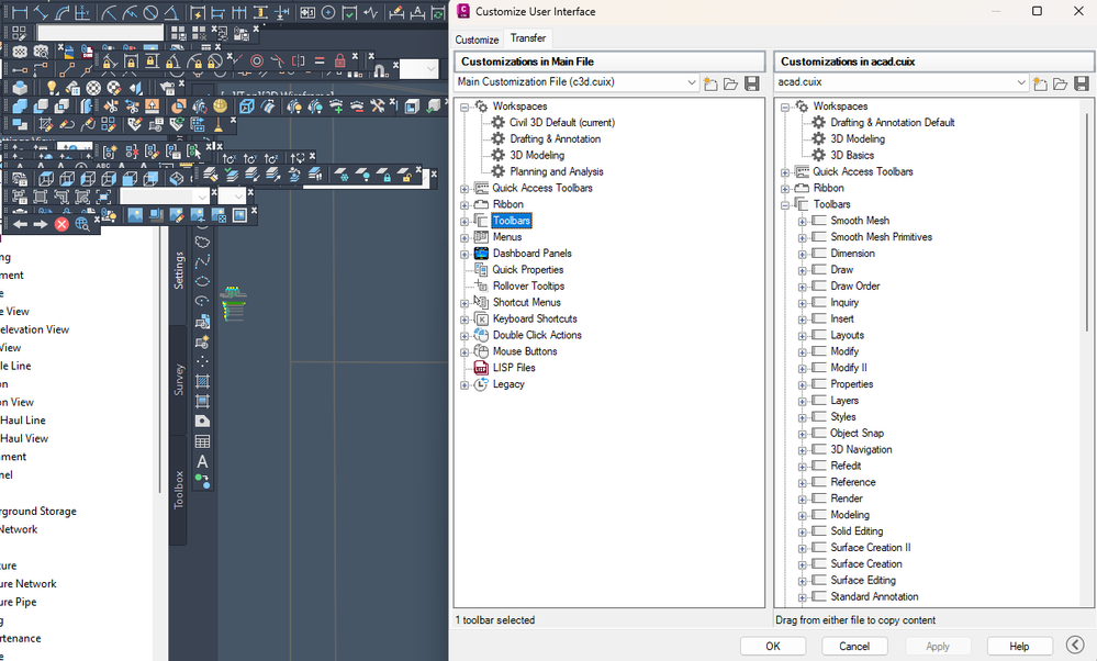

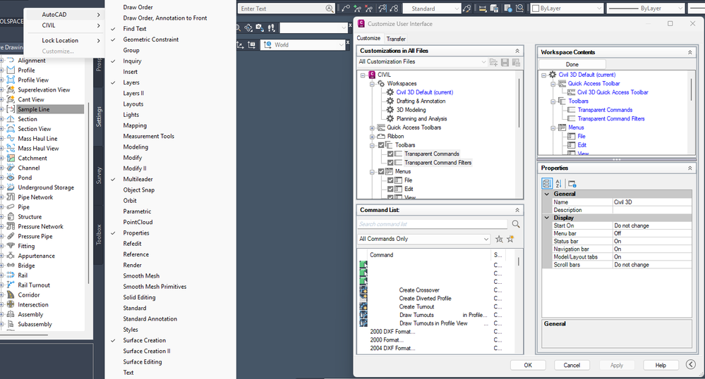

I would like to customize/copy toolbars to condense my toolbar array but they seem to be missing from my CUIX file. My fist picture shows the available toolbars, on the left, that are functioning in my drawing/profile but they are not present in the CUI Customization menu (picture 2 is what it should look like).
My LOCKUI is set to (0), MENUBAR is set to (1), I've unloaded and reloaded the CUIX file located in the file C:\Users\<username>\AppData\Roaming\Autodesk\C3D 202x\enu\Support) (both C3D.CUIX and civil.CUIX) , I've tried loading the backups and default versions located in the file C:\Program Files\Autodesk\AutoCAD 202x\C3D\UserDataCache\en-us\Support), and the toolbars are not properly displayed in the CUI menu.

Toolbars are available for use in the drawing but do not appear in the CUI customization menu or active workspace tools.Toolbars are available for use in the drawing but do not appear in the CUI customization menu or active workspace tools.
The toolbar dropdown on the right should look like it does in this image.The toolbar dropdown on the right should look like it does in this image.
I have tried loading the c3d.CUIX and civil.CUIX files with the same result. I also replaced those files in C:\Users\<username>\AppData\Roaming\Autodesk\C3D 202x\enu\Support) with the default files located in (C:\Program Files\Autodesk\AutoCAD 202x\C3D\UserDataCache\en-us\Support) with the same results.I have tried loading the c3d.CUIX and civil.CUIX files with the same result. I also replaced those files in C:\Users\<username>\AppData\Roaming\Autodesk\C3D 202x\enu\Support) with the default files located in (C:\Program Files\Autodesk\AutoCAD 202x\C3D\UserDataCache\en-us\Support) with the same results.

AliasEditor
Thank you for your help!
I had already tried a few things like CUILOAD, copying files over from the program files, and the user profile did not seem to be causing the issue either.
Thanks to your input I figured out I could transfer the toolbars from one of the partial CUIX files (acad.cuix). I am kind of new to CUIX files so I wasn't aware there are partial files and like with most things in AutoCAD, you cant find it unless you know the proper nomenclature. When copying over the toolbars into the same dropdown the system did register that they are there because it required overwriting to be copied over. Once they were copied over they all appeared undocked on screen (see picture). Weirdly this caused my docked and autohidden layer manager on the right edge to flicker. Saving the updated full CUIX, closing unneeded toolbars, and making an updated user profile seems to have fixed the flickering (see video).
