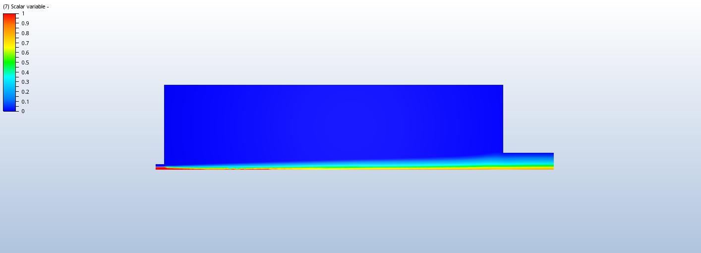

The scalar model used in Autodesk CFD show abnormal behaviour in terms of scalar quantity.
The following images show scalar, velocity magnitude and turbulent energy based on a scenario where two gases are injected into a large chamber. Mixing is underestimated [diffusive - not convective?] compared to experience and other software . Based on conversations with Autodesk support [feel free to comment], this is is a result of a solver using only diffusion coefficient rather than eddy viscosity to calculate solve the scalar trasport equation.
An update is critical - without this, the current scalar mixing implementation is of limited use.

Eric,
Have you tried using the Turb_Scalar flag that is available?
Would you be able to check that and see if it suffices with what you are asking for
With the release of CFD 2016 SP2, I believe this bug has been resolved.
