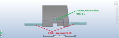

Hi All,
I am simulating smoke removal from an area.  I attached pressure=0 BC to inlets, and volume flow rate BC to outlets.
Fire is modeled as resistance with transient total heat generation, and scalar = 1 attached to its surface.  I also used film coefficients on all walls to simulate heat exchange.
I am running transient analysis with 3 inner iterations, and 0,5s time step.
I believe that I modeled inlets long enough but I keep getting recirculation on them, and after that divergence.  Is there any type of solution for this kind of problem?
I attached several screenshots and  CFD share file.
Best regards, Branimir

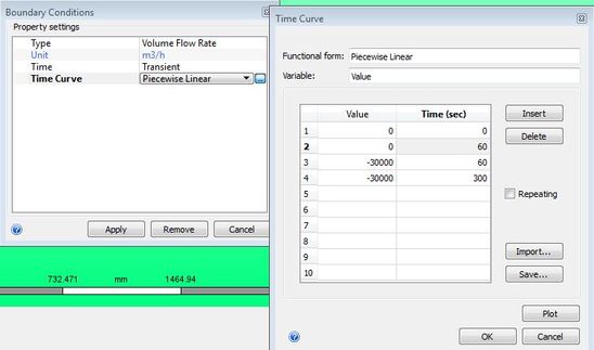

    1. Right Now  you have a mass imbalance of 58% which is too much to produce a good CFD analysis. This needs to be corrected in the first place. Furthermore,  I slightly change the way you set you transient BC
    3. What are the purpose of the shut off conditon for the first minute ?  Why does not simply start your simulation at t=60s ?? I think that cause recirculation thought your pressure BC.
